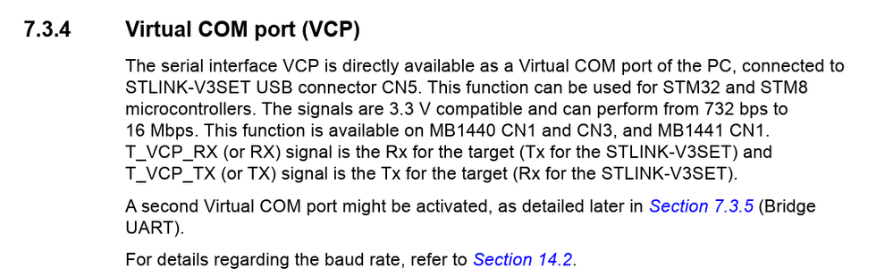

2025-01-24 12:06 AM
This is in the User Manual of ST-Link V3 Set. This should be clear.
