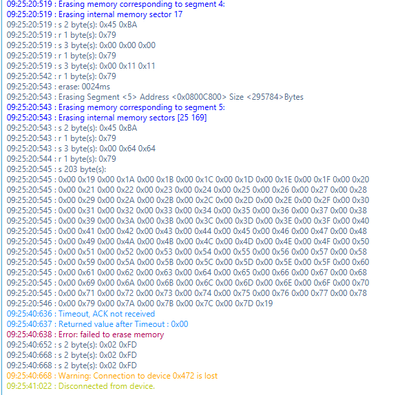

I forgot to mention that I have run the described use case with the STM32CubeProgrammer application in Windows 11 too, and I get kind of the same error, i.e. using the same hardware setup with the STLink and our STM32L5 mcu I connect to it in STM32CubeProgrammer over I2C and everything is "green". I then download the hex-file for the firmware update and click on 'Start Programming' in the STM32CubeProgrammer app. When starting it has 6 segments to flash, and it's when it comes to the 6th, i.e. the last, segment, which is the biggest one, it stops and signals an exception.
When setting the logging in STM32CubeProgrammer to Verbose level 3 I get the following output when it fails:

After further investigation, we managed to reproduce using STM32CubeProgrammer only. => Turns out this is either a bug in bootloader or STM32CubeProgrammer.
Issue is under investigation by STM32CubeProgrammer development team (Internal tracking number : 206729).
We will get back to you as soon as the issue is fixed.
