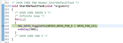

2025-10-23 12:59 PM - edited 2025-10-23 1:04 PM
Attached a project where the on board (STM32F769I-DISCO) LEDs are toggling in the default task.
I can set a break point and reach the GPIO toggle here:
void StartDefaultTask(void *argument)
/* USER CODE BEGIN 5 */
/* Infinite loop */
for(;;)
HAL_GPIO_TogglePin(GPIOJ,GPIO_PIN_5 | GPIO_PIN_13);
osDelay(500);
/* USER CODE END 5 */
Hope that helps

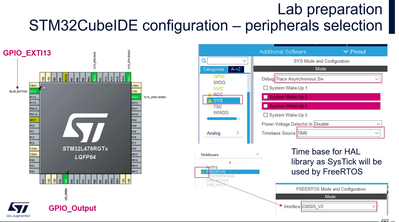

Hello @MCENG and welcome to the community,
Did you select another timeer for the system (HAL) and kept the FreeRTOS time base with the system tick?
See this video: FreeRTOS on STM32 v2 - 01 Preparation - lab
Slide at @4:05 it indicates that the "Time base source" needs to be changed to another timer like TIM6 and System tick needs to be reserved for FreeRTOS scheduler time base:

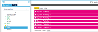

2025-10-23 12:25 PM
Thanks, glad to be here.
Yes I did take care of the Timers in a similar fashion to that shown in the video.
The difference being my debugger shows the only viable option as Serial Wire and all wakeup selections are highlighted
But, I will re-do them just to be sure.
Cheers,
MC
/* Infinite loop */
for(;;)
osDelay(500);
Hope that helps
2025-10-23 1:27 PM
Thanks for the application example.
It compiled and runs just fine. Still no breakpoint trigger in default task routine.
this seems so very strange.... maybe I'm just doing something wrong setting the breakpoint.
