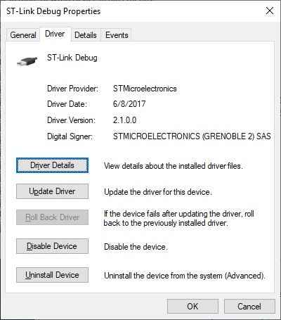

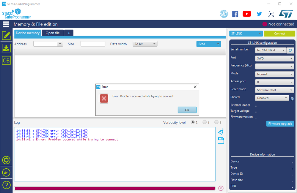

I have just obtained the STLINK-V3 device:
I have installed the STM32Cube Programmer (v 1.3.0) *** the drivers that comes along with it. The problem is that I cannot find the device:
There is no drivers missing, the device manager is "clean". I am using windows 10 64 bit version. Also there is no COM port available in the device manager.

Ok, but what driver is it reportedly using here? That would be the most helpful screen shot.
Will try a V3 in a Win10 box later but honestly, it doesn't look to me as if you have the right drivers loaded/functional.
Get it to refresh or find the most current drivers on your box, check the Win10 settings for allowing that to occur.

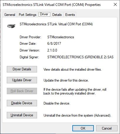

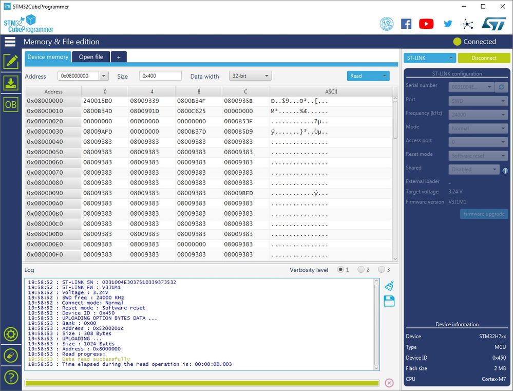

OK, So basically you've got an IT problem, you should be able to resolve this without involving ST staff. New Win10 box, installed STM32 Cube Programmer, attached ST-LINK/V3 device.
