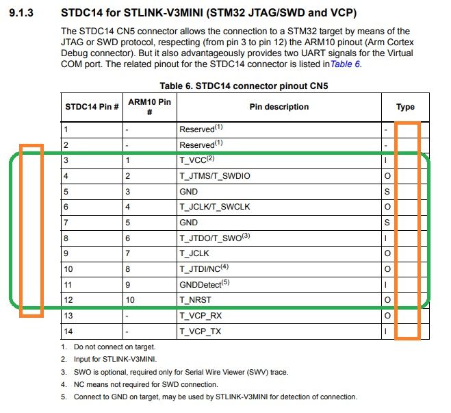

Yes, annoyingly the Mini only ships with one cable. This I think is an oversight as most available solutions use the 10-pin headering.
The 14-to-10 adaption is just to skip the 2 pins on either side of the center 10 pairings.
ie with the V3SET there is a 10-pin cable, one end crimps a 14-pin header, the other end a 10-pin header.

This means the IDF14 fits an IDF10 directly if there is no tall components around the 10 pin connector.
