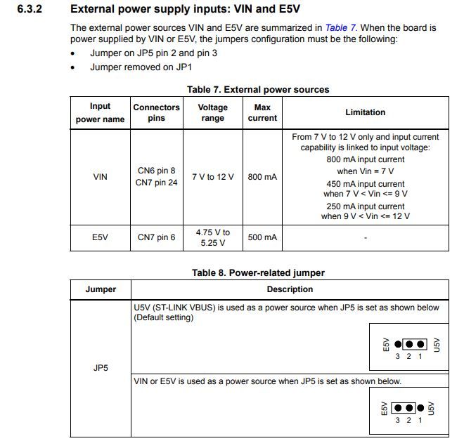

Hello @Tuğrahan Karakadıoğlu and welcome to the Community :)
Check the jumper position on the board.
Is the jumper JP1 ON or OFF? JP1 should be OFF.
Did you connect the external power to the PIN 6 of CN7.
If you use VIN (Pin 24 of CN7 or Pin 8 of CN6)
The external power sources VIN and E5V are summarized in Table 7 in the UM1724.
When the board is power supplied by VIN or E5V, the jumpers configuration must be the following:
• Jumper on JP5 pin 2 and pin 3
• Jumper removed on JP1
If the host is not able to provide the required current, the targeted STM32 microcontroller and the MCU part including the extension board are not power supplied. As a consequence, the red LED LD3 remains turned OFF. In such a case it is mandatory to use an external power supply as explained in the next Section 6.3.2: External power supply inputs: VIN and E5V. -UM1724-
In case the board is powered by a USB charger, there is no USB enumeration, so the led LD3 remains set to OFF permanently and the target STM32 is not powered. In this specific case, the jumper JP1 needs to be set to ON, to allow target STM32 to be powered anyway.
