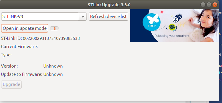

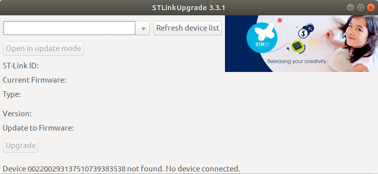

I am using Ubuntu 18.04 VirtualBox on MacOS with STM32G484QE-EVAL baord. While switching to STM32CubeIDE 1.1.0, the debug tool will ask to upgrade the STLINK V3 firmware. Clicking the upgrade button and "STLinkUpgrade 3.3.0" will start. Click "Open in update mode" button it starts to update. However, after a while, it failed. See the attached images.
2019-10-24 4:21 PM
In Virtualbox, when the device reenumerated, it most cases it detaches from Virtualbox. Reattach logical, with the VB control, not physical detach...
2019-10-24 5:07 PM
Reattached and run the STLinkUpgrade again and it still fails.
2019-10-25 3:26 AM
Try on a native machine, without VM.
