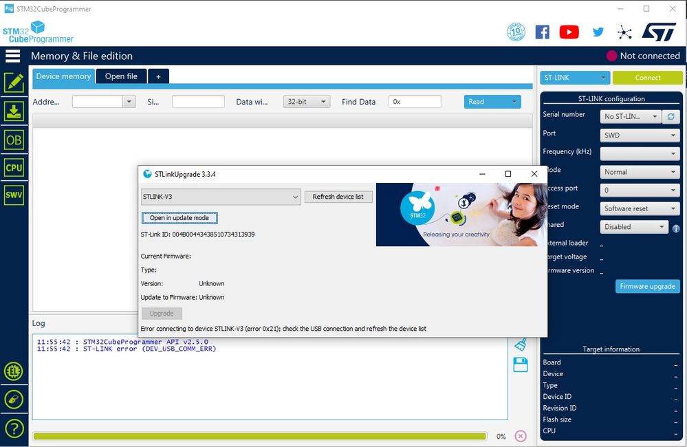

I totally cannot establish link with STLINK V3 as picture attached, just bought this ST-LINK V3SET few days ago, going to return it back in replace a new unit.

Please try to run STLinkUpgrade application out of any other application context:

hi S C,
I found the issues, the ST-LINK V3SET cannot be identified under USB HUB but when I connected directly to standalone USB port it works and upgraded its firmware to latest version as I documented this morning on the thread below:

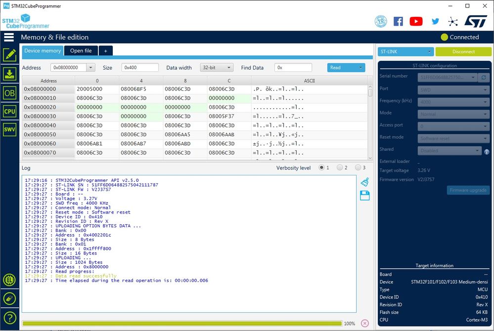

Thanks for the feedback, I used ST-LINK V2 able to connect three STM32F103C8T6 clone boards successfully shown below:
I already ordered NUCLEO-F103RB last week, as there is no stock available, I need to wait until March 2021.
I can accept the said of none genuine STM32F103 used here, because two of them are labelled CKS32F103C8T6 and remaining is labelled with ST logo but all three can be connected via ST-LINK V2 but not ST-LINK V3SET.
