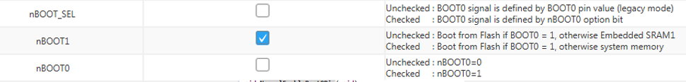

With STM32CubeProgrammer tihs is my option bits configuration.
I applied and then I read it back to check, and they re right.
nBOOL_SEL to 0 should guarantee the boot selection with boot0 pin.
The strange tihng is that happen just if I've connected the programmer before. If I power off and power on my board it works perfectly.
