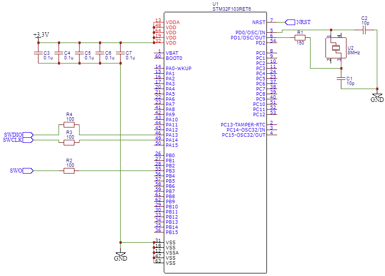

I have a custom STM32 board which has basically only the needed components to flash and use an STM32F103RET6 on board. This means, there are only a few capacitors for voltage stability, an 8MHz quarz + circuitry, and a few connectors on it.
I have the SWDIO, SWCLK and NRST lines connected through a 100 Ohms resistor exposed so a connector, so I can use them to program the device.

Schematics:

We found the issue.
The Problem was that `VDDA` pin had not enough energy supplied to it.
This means, it was a hardware issue.
To make clear what the actual problem was and why we didnt detect it:
We checked all `VDD(A)` pins and found that every pin had the right voltage supplied. However, in the gerber files we discovered that the `VDDA` pin via was not connected properly to the 3.3V plane. There was a huge resistance (in this case 600kΩ) between the 3.3V rail and the `VDDA` pin. We measured the right voltage at the `VDDA` pin because there was a capacitor and it had enough time to charge up. Thus we measured the correct voltage. However, once the uC started to draw actual power, the cap didnt provide enough energy/current and the uC couldnt start up. That also explained the error message from JLINK "Couldnt start up DAP".
Ergo: `DEV_TARGET_CMD_ERR` is probably a hardware issue.

2023-03-16 6:38 AM
We found the issue.
