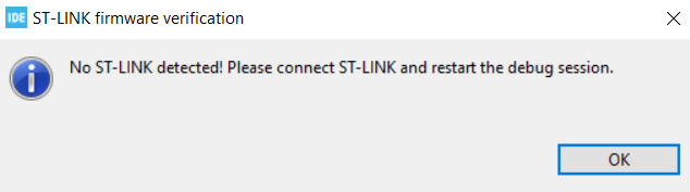

When I try too start debugging I get this message:

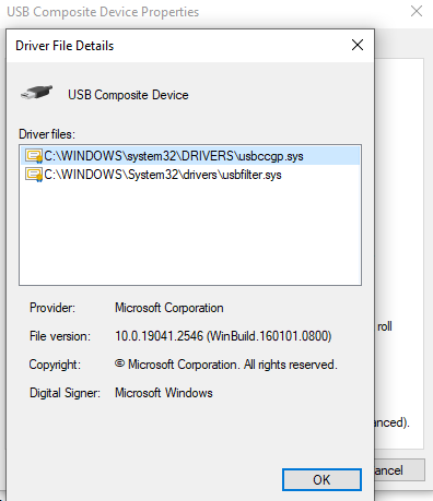

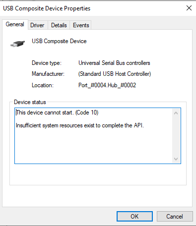

I checked the drivers and the device is showing as a USB Composit Device and I have no alternative to change the driver.
I installed en.stsw-link009 and successfully installed some drivers but they are not available in device manager.
I uninstalled the device in device manager but still no change.
I even installed the newest STM32CubeIDE 1.12.0 but still no change.

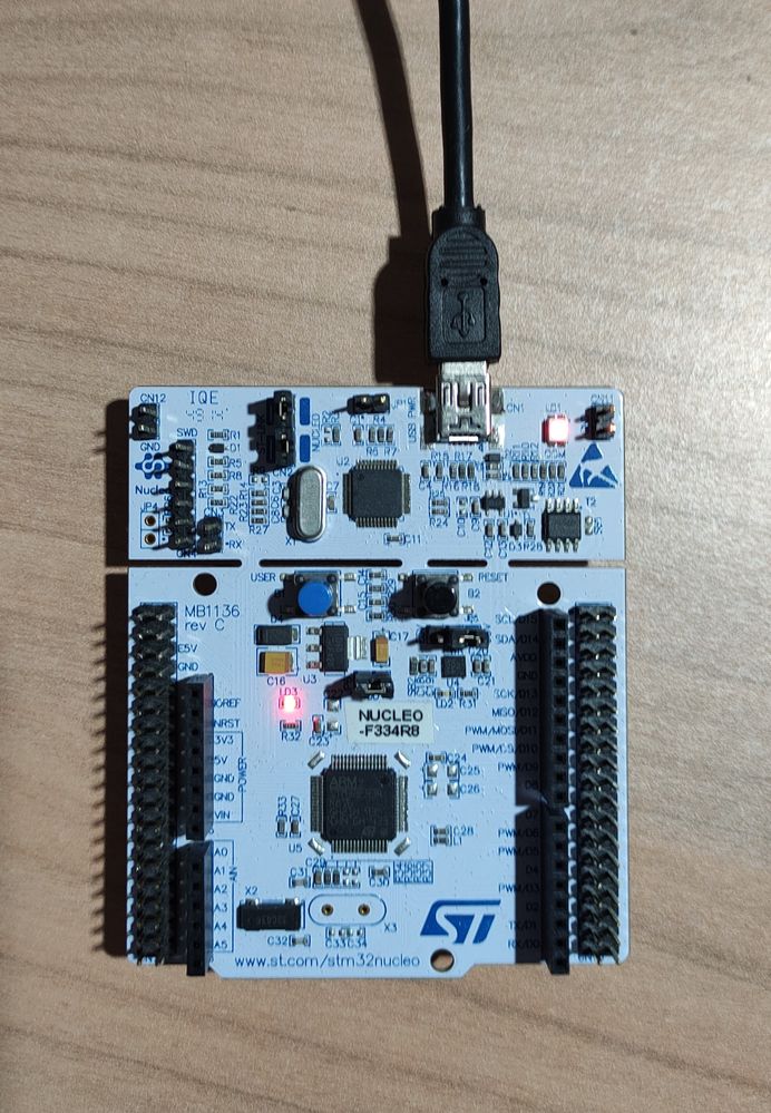

2023-03-16 8:32 AM - edited 2023-11-20 9:11 AM
yes it's a NUCLEO-F334R8
now it's not connected so there is no light, when connected it has 2 red leds showing

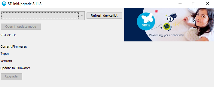

OK, please try to upgrade the embedded ST-LINK/V2-1 using STM32CubeIDE and the command:
Help > ST-Link Upgrade
2023-03-16 8:36 AM
It doesn't recognise the ST-LINK/V2-1
2023-03-16 8:42 AM
The ST-LINK/V2-1 cannot be recognised because it does not receive any supply voltage.

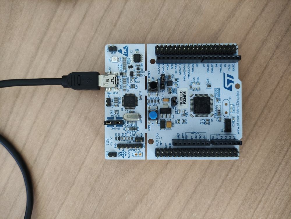

I recieved this device from somebody and it already has some jumpers:
can I remove any of these?
2023-03-16 8:57 AM
The two GND jumpers at the bottom are spare ones, your can easily take any of them.
