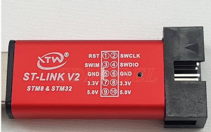

I am not sure which pin is CN3.15. The ST-Link I have is shown below. RST is connected with my MCU's NRST.
I hope I am not having issues because it is not made by ST. Do you think that's a possibility?

The use of NRST you indicate should suffice.

Seems this probe is not working properly.
May I suggest you to get ST Standalone probe or keep using Nucléo STLINK/V2-1 ?

I had very similar issues with that knock off ST-Link. As far as I can tell the RST pin is driven only when used in SWIM more (for STM8), not SWD.
I'd suggest you reflash the thing with
and remap the RST signal from PB0 to PB6.We’re moving the ST Community to a new platform to give you a better and more reliable community experience.
