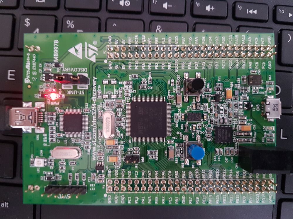

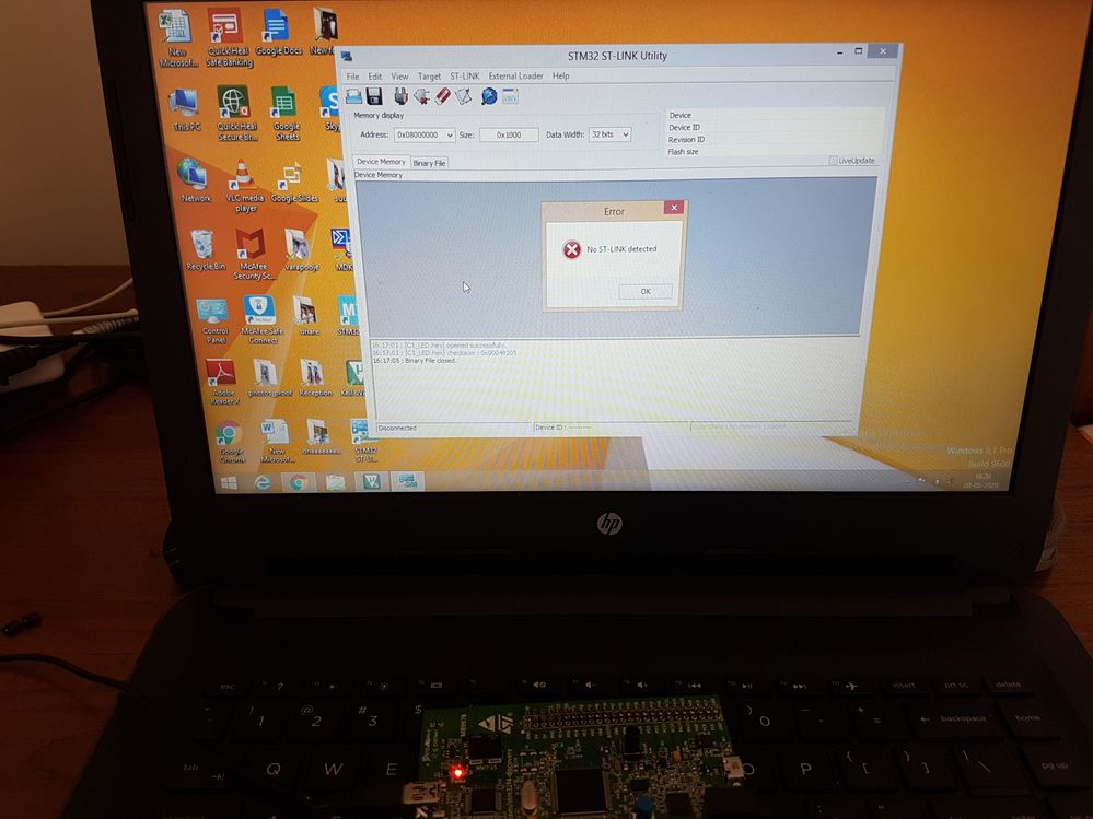

Try a different cable, and USB port.
Keil and ST-LINK Utilities cannot use the pod concurrently. Close Keil to test this.
2020-06-08 5:13 AM
also try with STM32CubeProgrammer
