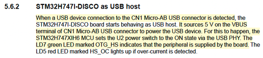

According to the reference manual, LED7 should light up green when the ULPI PHY detects a USB connection and the board is acting as a host. In my case, this LED turns on even before connecting any USB device.

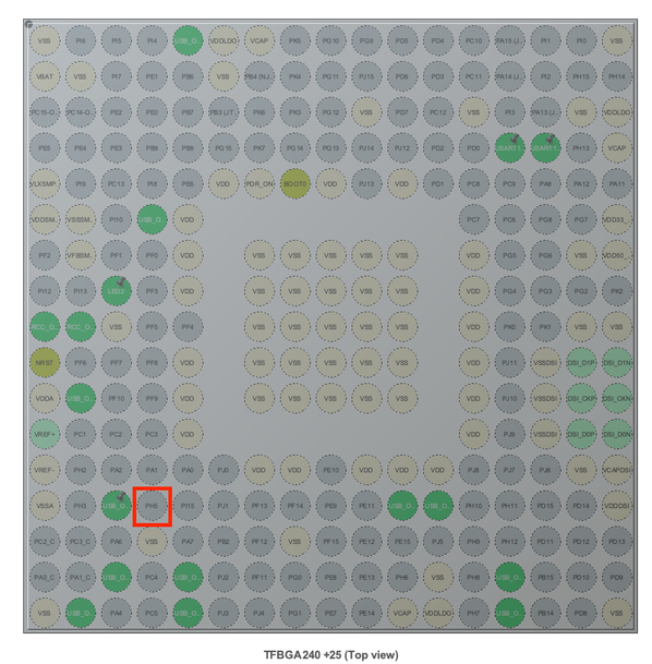

Also, this function writes a pin that is not set in the FW (GPIO Pin 5 Port H):
* @brief  Drive VBUS.
*   state : VBUS state
*          This parameter can be one of the these values:
*           1 : VBUS Active
*           0 : VBUS Inactive
* @retval Status
void USBH_DriverVBUS(uint8_t state)
  /* USER CODE BEGIN 0 */
  /* USER CODE END 0*/
  if (state == USB_VBUS_TRUE)
    /* Drive high Charge pump */
    /* Add IOE driver control */
    /* USER CODE BEGIN DRIVE_HIGH_CHARGE_FOR_HS */
    HAL_GPIO_WritePin(GPIOH, GPIO_PIN_5, GPIO_PIN_SET);
    /* USER CODE END DRIVE_HIGH_CHARGE_FOR_HS */
  else
    /* Drive low Charge pump */
    /* USER CODE BEGIN DRIVE_LOW_CHARGE_FOR_HS */
    HAL_GPIO_WritePin(GPIOH, GPIO_PIN_5, GPIO_PIN_RESET);
    /* USER CODE END DRIVE_LOW_CHARGE_FOR_HS */
  HAL_Delay(200);

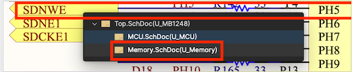

In fact, this pin corresponds to one input pins of the RAM memory:
screenshot from the design files MB1248-H747I-D03 (downloaded form ST)

Am I missing something in the setup? I was expecting LED7 to remain off until a USB mass storage device is actually connected.
