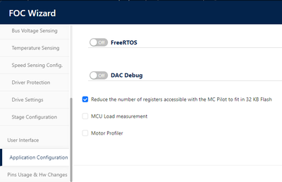

2025-05-27 10:34 PM
Hello @GMA,
Thank you for your response.
I have already reduced the number of registers accessible via MC Pilot to fit within the 32 KB Flash constraint. However, I’m still encountering the same error:
'FLASH' overflowed by 572 bytes
Could you please advise if there are any other optimizations or configurations I should check to resolve this issue?

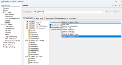

2025-05-30 5:54 AM
Hello @Sunil_Kumar_G,
By default, IDE Optimization is -Ofast, did try size optimization options?
