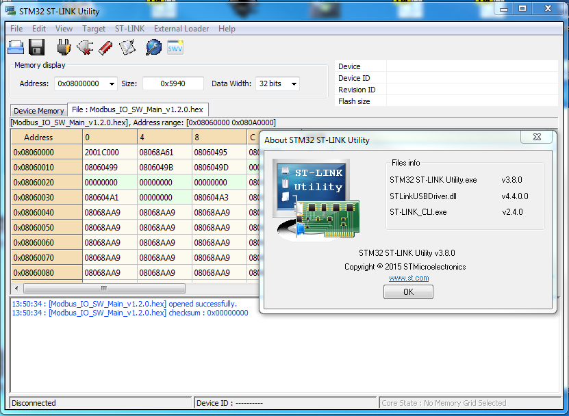

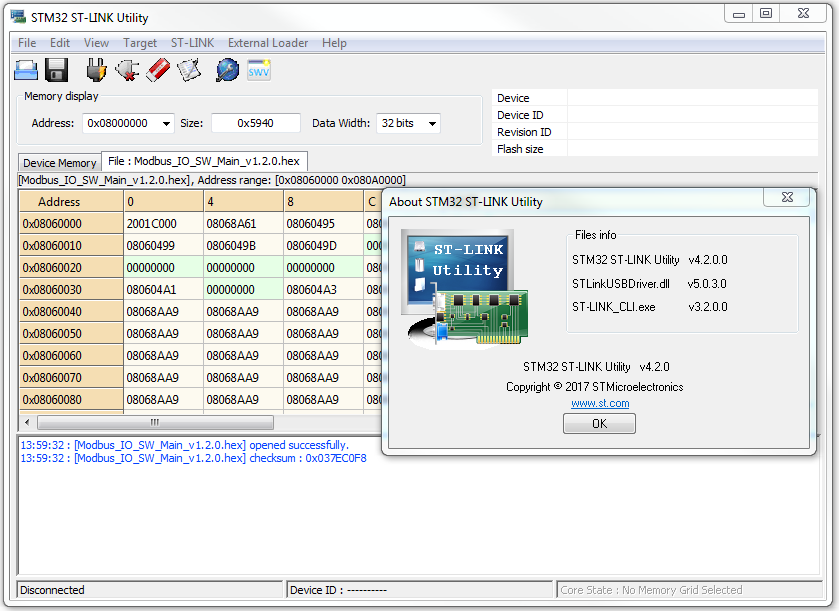

recently i upgraded my ST-Link Utility from v3.8.0 to v4.2.0, within that change the value of the calculated checksum for the same Intel-HEX files changed. Below there are screenshots for the different ST-Link Utility versions respectively. In the change-log of ST-Link Utility i did not found information regarding a change in checksum calculation.
Please provide information about this changed behavior.
Thank you!
v4.2.0
v3.8.0

Improbable that it is zero, looks consistent with a sum of bytes.
"Memory checksum
The checksum is calculated based on an arithmetic sum algorithm, byte per byte. The result is truncated to 32-bit word.
The checksum value is displayed in the log window"
