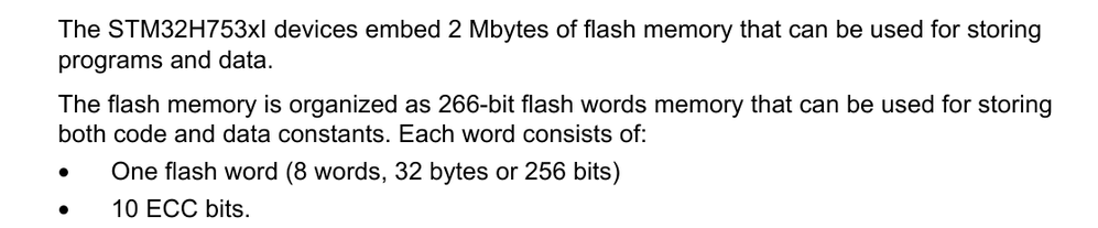

Some series have error detection+correction in flash , if need 100% safety always, example H7 series ->
