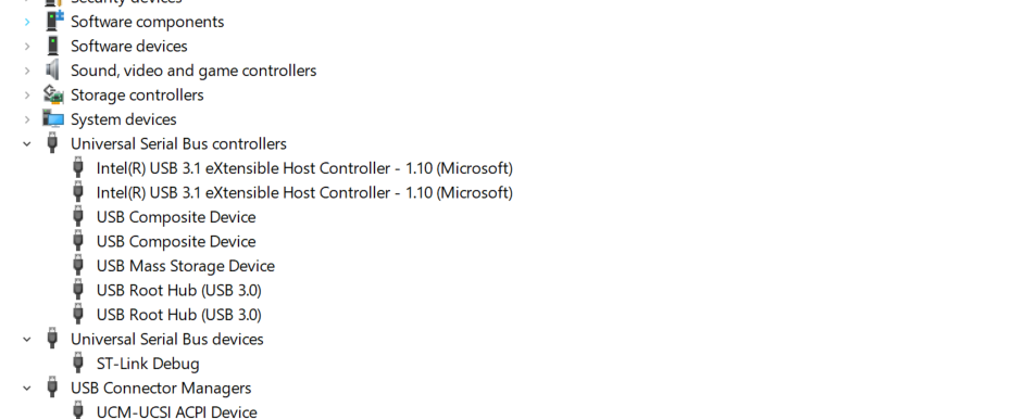

Check the usb cable and also the usb connector, maybe there is an issue on the USB connector of nucleo board ?
In Windows Device Manager, If you can see the STLink debug in USB devices, it should be ok.

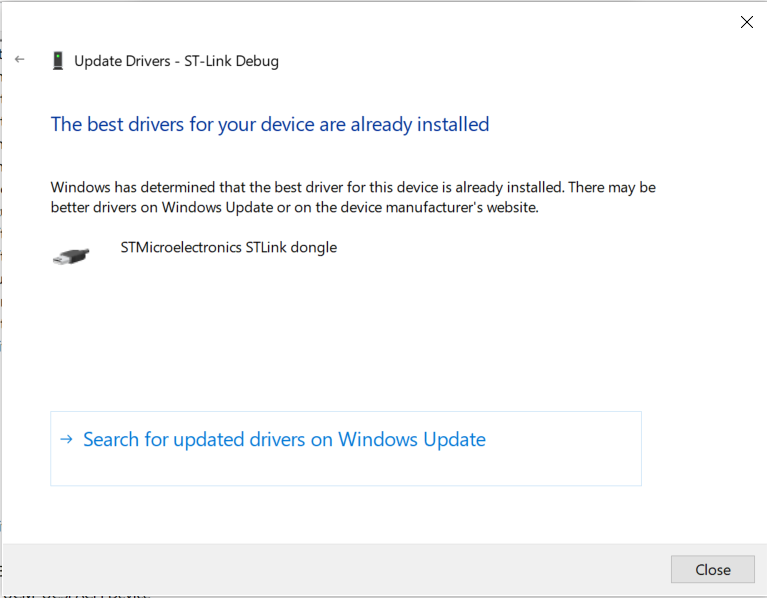

2021-01-20 2:08 AM
I did used the installer to install the STM32CubeIde (v1.5.1). And I have to used the above process to debug otherwise it always shows No ST-LINK detected.
I checked and I know it has latest STLink server tool but I think on my laptop is not working. I changed several usb cables and I just bought a new nucleo board and still not work.
In Windows Device Manager, I can see the STLink debug in USB devices, but still not work.
I tried to manually search for the driver in ST folder and it cannot be changed.

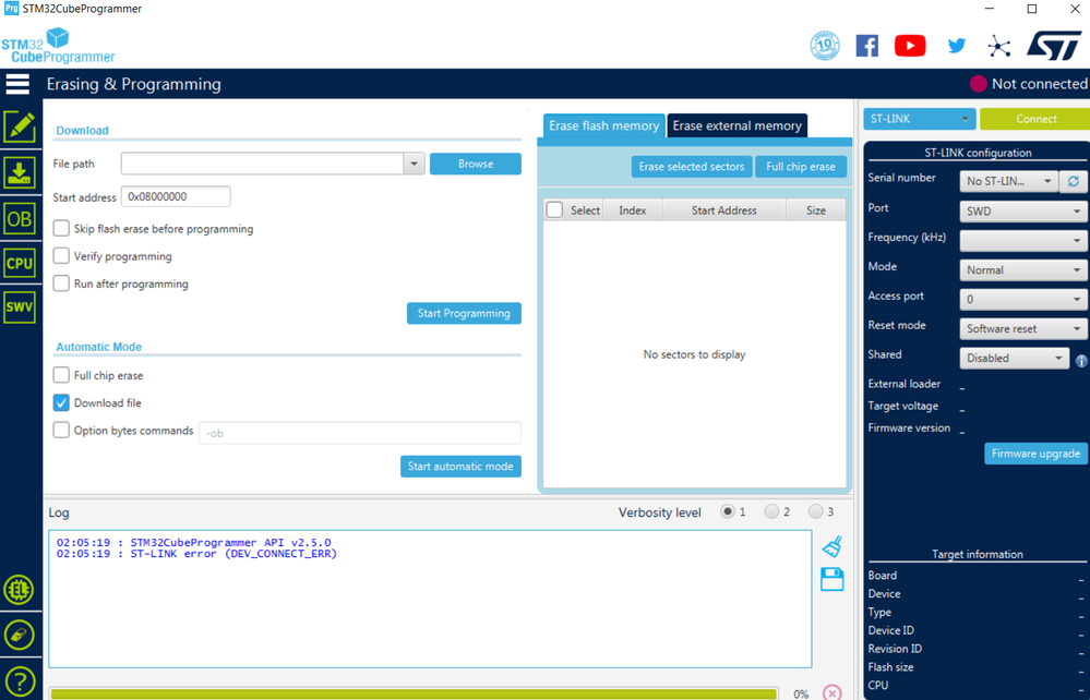

In STM programmer, I have to do the same thing to be able to find the board: quickly install the usb and click "firmware update" and it can be detected for just several seconds. Btw, How do I mass erase the device?

Mass erasing the device can be done with the eraser (bottom left button).
I suggest you to connect with hardware reset and connect under reset.
But you must solve your stlink issue first I suppose.
