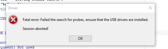

I have an stm32f401vc discovery card, I can't download and debug the code you can find the error in this picture

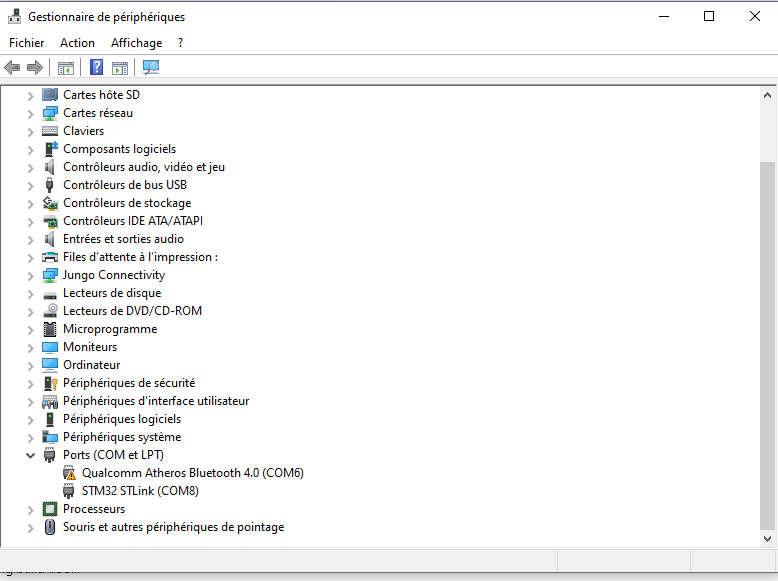

when I connected the card to my pc here is what I found in the Device manager

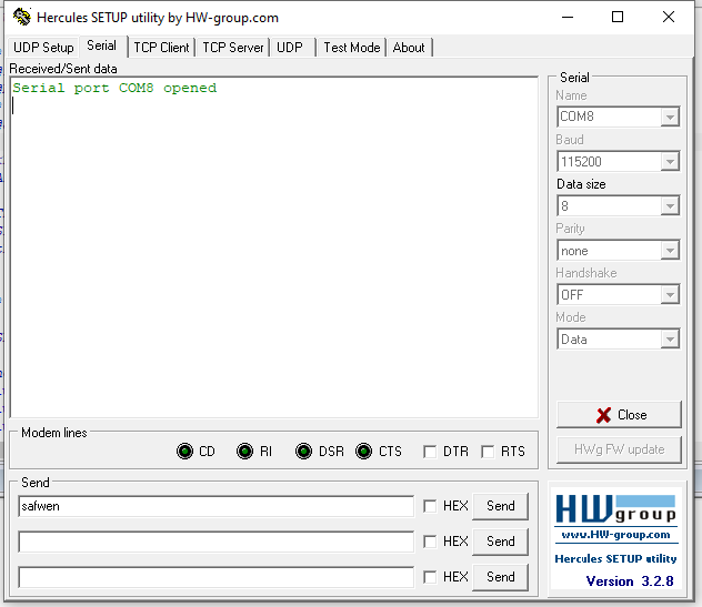

the most shocking thing that the serial port works

it seems that the driver is not installed or installed incorrectly. VCPort(com8) is not stlink for debug. Only mini USB side of the board must be connected to PC.
Download drivers from here ..
