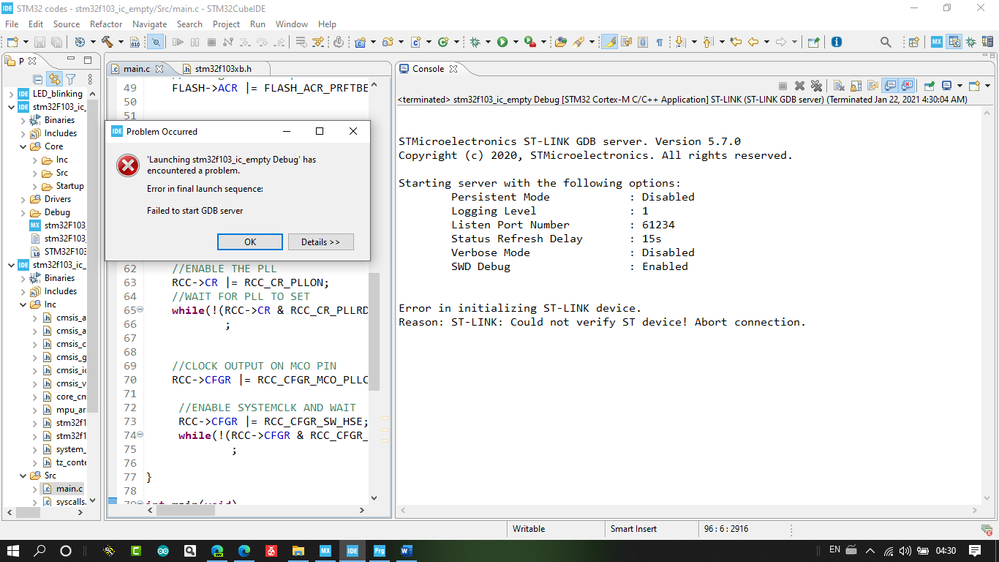

This error is coming when I RUN/Debug program using STM32CubeIDE.
I am Using ST-LinkV2 and STM32F103.

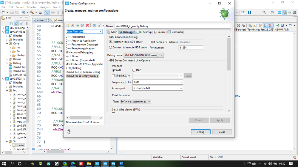

These are my debugger setting in CUBEIDE for reference.
Is my settings correct???? if not then tell me what to correct.
P.S. ST-LinkV2 programmer and debugger is successfully flashing codes on the chip with the STM32CubeProgrammer.But showing error with CubeIDE. So pretty sure that problem is with my Settings in CubeIDE. But Don't know what exactly changes to be made

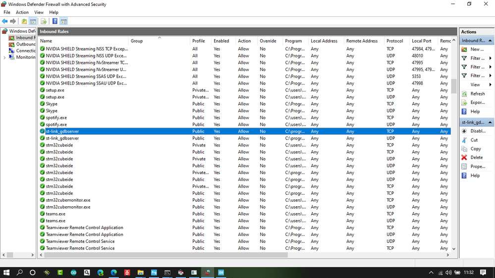

install latest gdb server software. Open firewall settings go to ibound connections and check if st-link_gdbserver is enabled. Check all the rules that contain gdbsever and enable it to allow connections for private and public networks

2021-01-23 10:12 PM
well here it shows two labels with st-link_gdbserver and one of them was disabled, so I enabled that one.
can u tell what do u mean by check all rules of gdbserver???
after enabling, I restart my STM32CubeiDE and debug the application but still showing same error.
