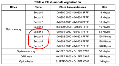

Error in STM32CubeProgrammerThis issue is only present when I use HAL drivers to erase a portion of the flash memory of the chip, as shown in the below code snippet. I do not believe that I am erasing any of my code, as the flash erase starts in sector 3, and the build size of my program is ~42Kbytes, which should only take up sectors 0-2.

This worked for me...
2024-05-09 10:26 AM
2024-12-09 1:03 PM
This worked for me! Thanks for the explaination. 1s deday sufficed for me.
Also, debugging without reflashing also works, but it implies that you can't modify the code you're trying to debug, which is cumbersome to say the least.
2025-03-06 5:57 PM
Thank you for explaining, this solved my issue too. Can someone fix that answer?
