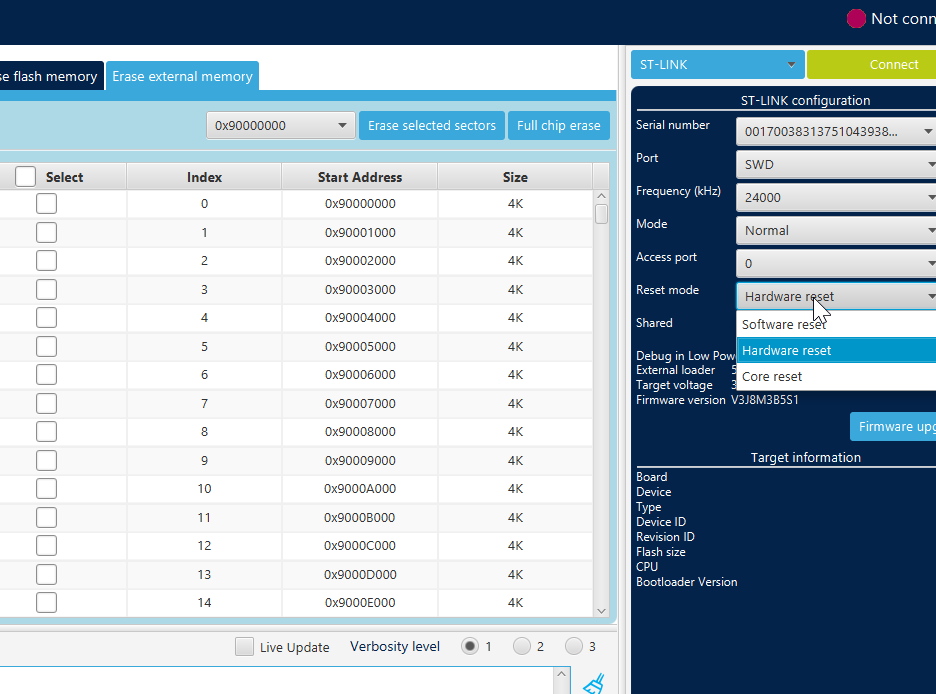

I had the same issue after flashing a corrupted build.
The solution is to select Hardware reset under Reset mode in STM32Cube Programmer
