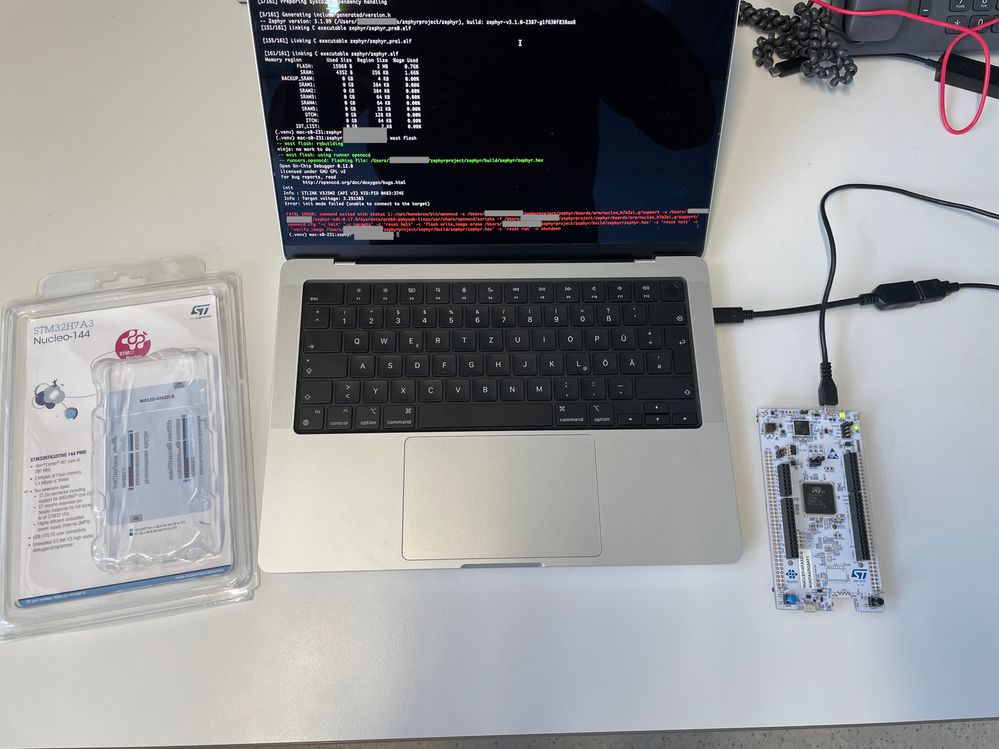

Thanks for your input. Here is a typical example, new Nucleo-Board just unboxed. This setup will sometimes work, sometimes not.

If this was happenning to me i would try with another PC another usb cable and another nucleo board, and then slowly one by one introduce the old setup back.
2025-02-26 9:55 AM - edited 2025-02-26 10:02 AM
Ah, that's a MAC! Maybe even a new ARM based MAC. Please try a powered hub. Though it definitely may hurt the minimalism of the setup and overall aesthetics. (If the hub will help, you can hide it behind the screen or paint it white).
If possible, please share logs from the debug terminal pane of CubeIDE and other useful logs. Look in the system logs of OS/X if there's anything indicating USB issues.
