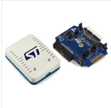

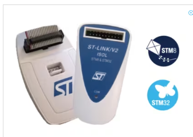

There are different STLINK versions available on the market, two of them are:
ST-LINK-V2: https://www.st.com/en/development-tools/st-link-v2.html
and ST-LINK-V3: https://www.st.com/en/development-tools/stlink-v3set.html
So could you confirm which one you have? or at least post a photo for it top and bottom of it?

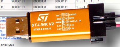

@abczhang wrote:The one I'm using has a different shape; it has two interfaces, one STM32 and one STM8.!
So one like this:
Yes?
You still need to check that it is a genuine ST one.

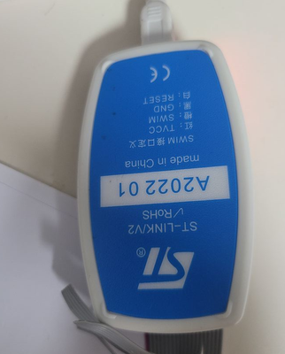

+ If you have this one as bottom image with Chinese text, it's a ST-LINK clone:
Please read this thread: ST-link V2 Connection error
