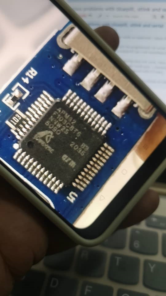

How do I know its fake?

ST Microelectronics manufactures microcontrollers whose names start "stm32"
I do not know which chip manufacturer makes chips where the name starts APM32. I would not call it a "fake" because as the name doesn't start "stm32", the chip isn't claiming to be an ST part. They might be implying that it has similar capabilities to the stm32f103 and it might, with effort, be able to use it in a similar way. But maybe only for "simple" things - if you start to use the advanced features of the ST peripherals you may hit problems.
A demo-board supplier might stuff these APM32 chips onto their boards; if they claim it is stm32 (or stm32-compatible) then they are the ones who are doing the counterfeiting.
But you shouldn't expect ST, who write stm32cube with a view to selling more of their own chips, to put much effort into making it work with a competitor's products unless they saw some reason to do so.
Now I'm not affiliated with ST so I shall try to be helpful. You might find that other programmers can cope with non-ST parts. I seem to remember the hackaday website had a blog entry on what people had to do in order to program these not-quite-stm32 devices.

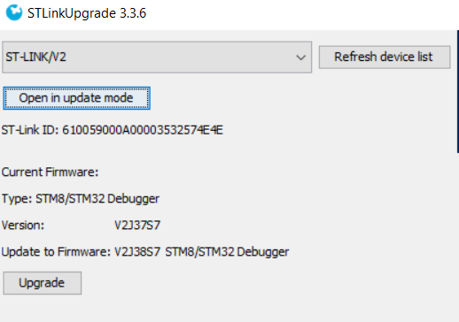

This MCU is made by GEEHY (formerly Apexmic, hence the APM32) and it will not work with STM32 Cube Programmer. Unfortunately, recently, all these clones come with this MCU. It will see it only in firmware upgrade mode (DFU), otherwise it will not read its serial number, nor it will be able to connect to target MCU. However, it will work fine, with an old STM32 ST-Link Utility. It is also possible to update its firmware using official tool, and this tool will see device ID after switching to DFU mode. In normal mode, the ID will be a single capital letter, like F or Y.
I have "repaired" one of such ST-LINKs, by programming a "Blue Pill" with an old (V2.J16.S4) ST-LINK v2 firmware found on the Internet, and replaced the APM32F103CBT6 in the ST-LINK clone, with this programmed STM32F103CBT6 from the "Blue Pill". Now it works fine with the STM32 Cube Programmer. Blue Pill with APM32 also works, but for Arduino it has to use gd32f1_generic_boot20_pc13 bootloader.

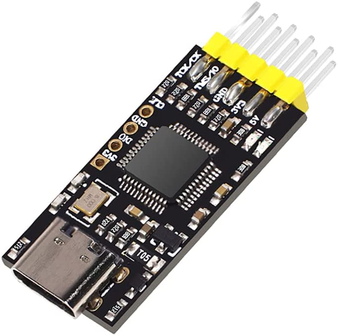

I've got some NS32F103 based boards here, but they are CMSIS-DAP ones, so side steps the whole ST-LINK issue, and work in KEIL with STM32 parts attached..
Not bad really as they provide SWD and UART/VCP connectivity, uses USB-C connector.
