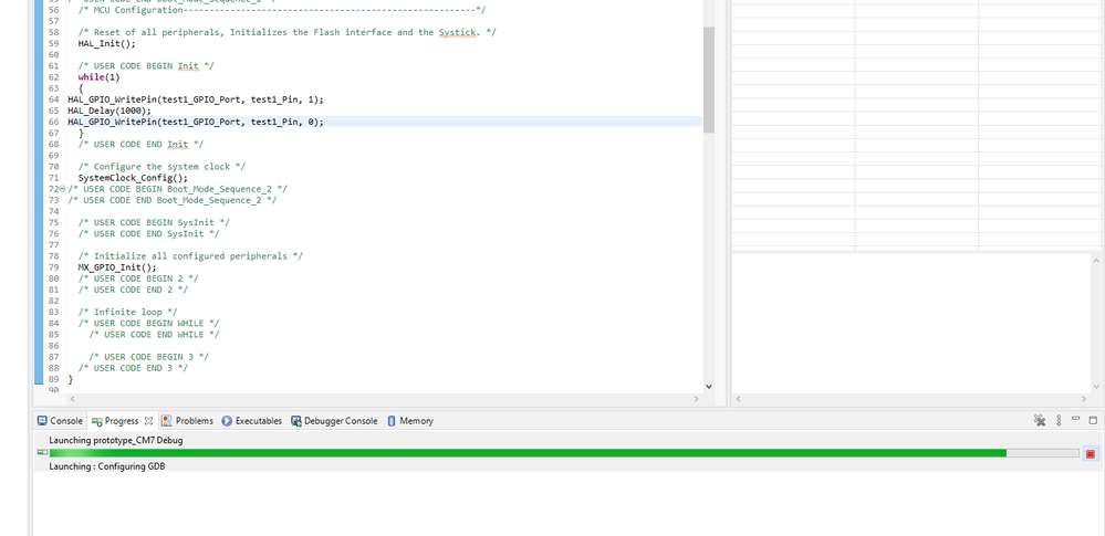

2022-03-01 2:09 PM
this is whats happens before i see an error, it is stuck there for 5 min and then error pops up
