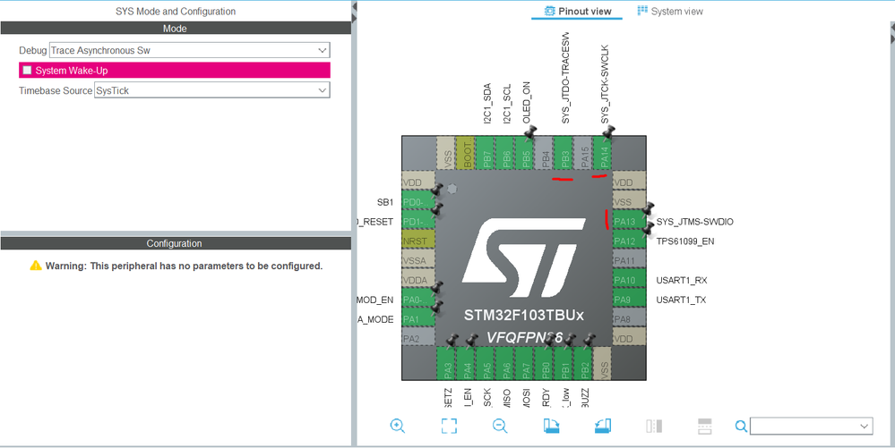

I turn on Trace Async Sw:

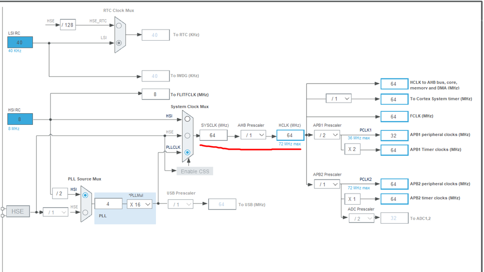

My clock:

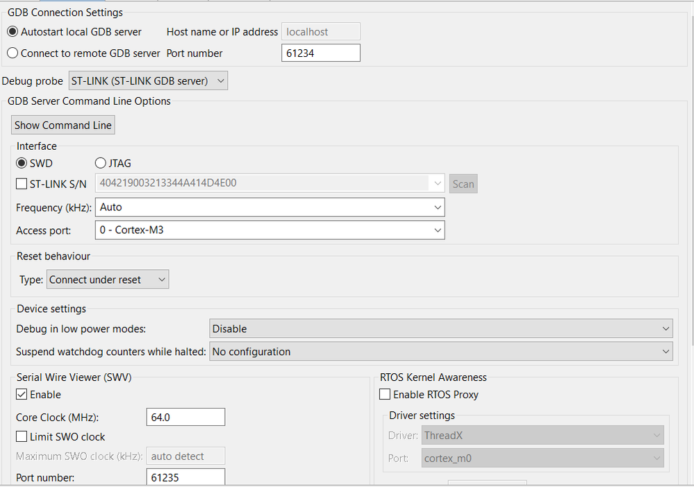

}Setting up debug:

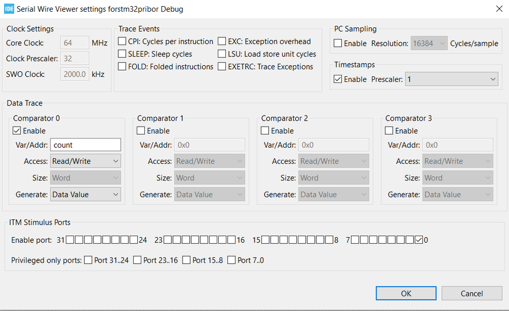

Pressing "Start Trace" and resume code.
And I see nothing in SWV tabs =(
What wrong in my program?

PB3/SWO pin connectivity required.

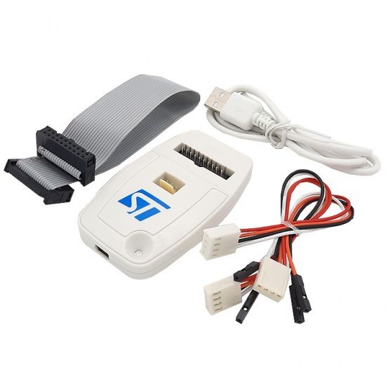

This programmer should be enough for SWV trace? I can't find some more info about it :p

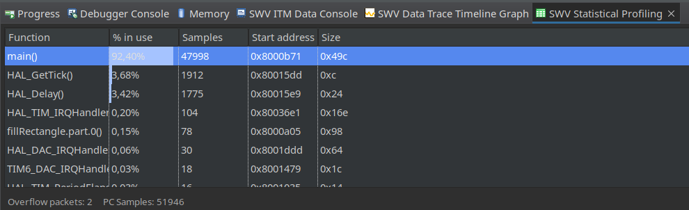

here statistics:

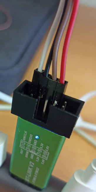

Yes, I will do it. But I need "plan b" if it wont work as well. As I understand in ST-Link as shown upper have SWO and JNRST pins, right? And I can use it for SWV Data Trace...
