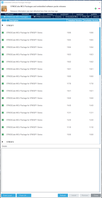

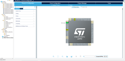

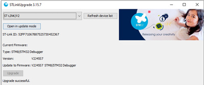

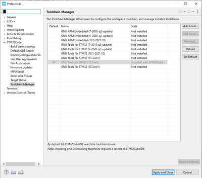

I'm leaving images about package updates and settings below.
Finally, I created a project from scratch to turn on and off the LED on the STM32 Blue Pill board and I am sharing the details with you, it did not work in this project.

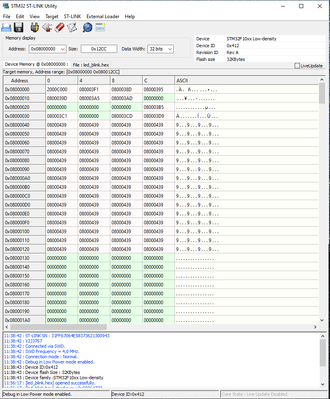

stlink screen
st link mesage
11:38:42 : ST-LINK SN : 31FF67064E58373621300943
11:38:42 : V2J37S7
11:38:42 : Connected via SWD.
11:38:42 : SWD Frequency = 4,0 MHz.
11:38:42 : Connection mode : Normal.
11:38:42 : Debug in Low Power mode enabled.
11:38:43 : Device ID:0x412
11:38:43 : Device flash Size : 32KBytes
11:38:43 : Device family :STM32F10xx Low-density
11:56:17 : [led_blink.hex] opened successfully.
11:56:17 : [led_blink.hex] checksum : 0x00064773
11:56:20 : Memory programmed in 0s and 812ms.
11:56:20 : Verification...OK
11:56:20 : Programmed memory Checksum: 0x00064773
11:56:21 : Flash memory [0x08000000:0x08008000] Checksum: 0x003D2887
