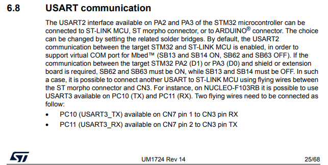

@2001jolly wrote:I have connected PA2 and PA3 pin of the board to the FTDI
Note that, by default, those pins are connected to the ST-Link's VCP (Virtual COM Port) - so there's no need for a separate USB-to-UART adaptor:
If you do want to use a separate USB-to-UART adaptor, you will need to disconnect the pins from the ST-Link's VCP.
