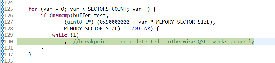

I use STM32H750B-DK to do external loader function.
"H750_External_Loader.zip" is my test code.
On below have error happen, I got error while memcmp
That's the code that I've used as my base:
https://github.com/WellinZHANG/External_Loader

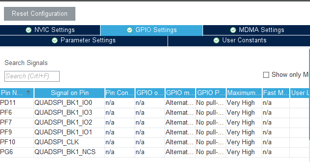

QSPI Setting
EVM STM32H750B-DK Flash

The issue may be memory mapped fail, because I try to
memcmp(buffer_test,(uint8_t*) (0x90000000 + var * MEMORY_SECTOR_SIZE),1) still fail.

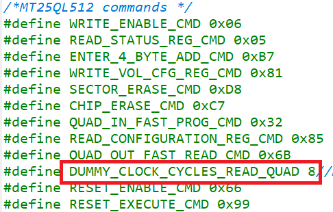

If it's already failing at the first byte then perhaps the command/template is wrong.
Check dummy cycles, command format, etc.
