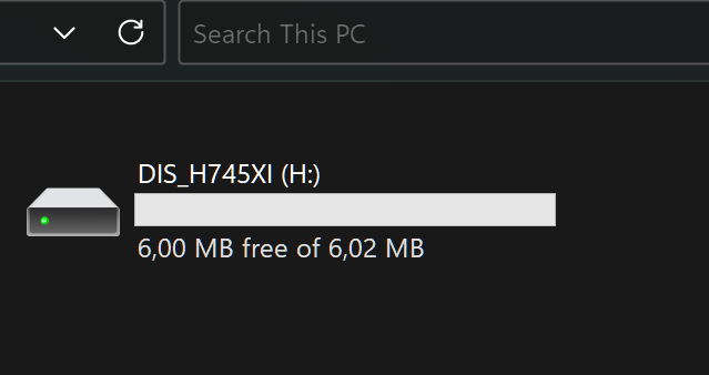

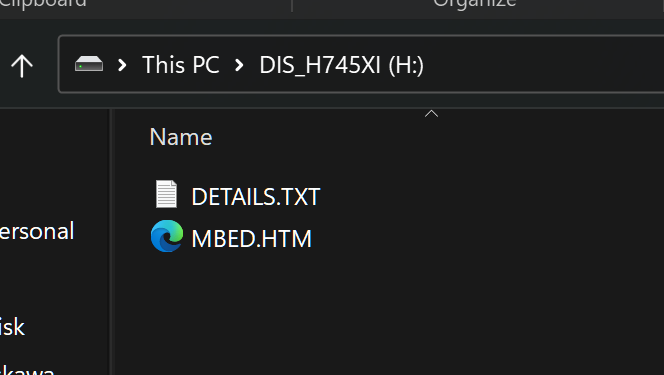

However, the device is seen as an USB disk.
The problem is - the HEX file is too big to fit in there. Is there a workaround for it?

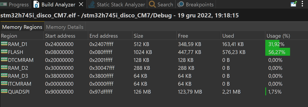

I tried to generate a BIN file, but it's 2GB - why? My whole project doesn't use that much data.
Here:
I need to send the update to someone that has the device, but no ST software installed. What are the options?
My plan B is to send them CubeProgrammer and HEX file.
BTW, HEX file is not the optimal in size. It stores the binary data as text, that use at least 3 times as many bytes as raw data. Why is BIN 2GB? It should be smaller than HEX. Is there any other format that could be used to flash the chip by just copying the file to that special "UBS disk"?

>>Why is BIN 2GB?
Because binary files can't be sparse (ie containing large voids), and describe memory at 0x08000000 up through 0x90000000, which is around half the 32-bit 4GB address space.
You'd need to break it into pieces, some of the better tools will do that.
Still the QSPI space is bigger than 4MB, and not supported by the ROM boot loader. It supporting the eMMC would surprise me.

OMG, I missed your answer earlier, QSPI data is labelled as FlashExt by TouchGFX and I think it doesn't always require updating. Correct me if I'm wrong, but I believe it the TouchGFX uses QSPI memory to store its assets, so if the assets are not changed, I don't need to update that part of memory. So now - how can I remove the QSPI part from the HEX file? The hex file is generated by linker built in STM32CubeIDE. It's generated using the linker script that is also generated by STM32CubeIDE.
2022-12-22 9:13 AM
Likely spit out via OBJCOPY in this instant.
I'd kind of expect the .HEX to be relatively linear, so you should be able to find the record describing the 0x90000000 basis, it will be a shorter record, as the blocks of data span 64KB in most cases.
You should be able to cut the data with an editor/script, leaving the closing records. The patterns should be easy to match.
OBJCOPY or SRECORD should be able to narrow things down, not tools I use day-to-day.
