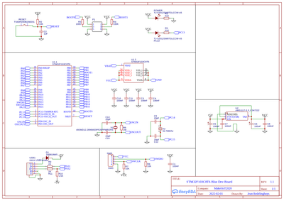

I created PCB by basically following this design, but I used as MCU the STM32F303CBT6. Programming through FTDI programmer works all fine, but when I try to use the onboard USB port, Windows doesn't want to accept it and in device manager says that i...

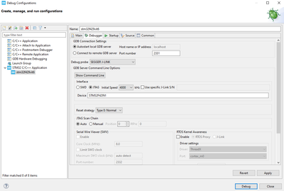

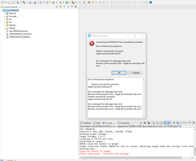

I am using STM32CubeIDE for my project . when i want to run the code i am getting this pop up.i am not able to solve this issue.
Hello, I am working on the project from scratch. I would like to know what are the minimum connections I will need for the STM32F429VIT6 in order to program? I have segger J-Link which I will be using. so far I have connect SWCLK (Pin 76), SWDIO (Pin...

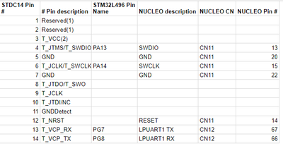

I'm running a STM32L496ZGT6U on a NUCLEO-L496ZG. Previously, I used the NUCLEO's integrated ST-LINK/V2-1 debugger/programmer. Now, I have sawed off the ST-LINK part of the PCB. I want to program and debug using a STLINK-V3MINI. I wired up STDC14 for...
In UM2179 Rev 9 it says:"5.4.4 Using ST-LINK/V2-1 to program and debug an external STM32 application...Note:JP4 NRST (target STM32 RESET) must be open when CN3 pin 5 is used in an external application."This is CN3: I think that should be CN5.
