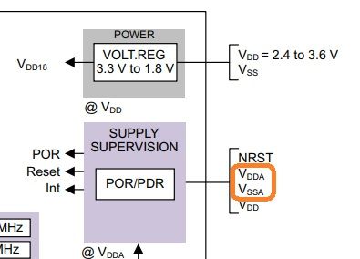

2019-05-10 7:38 AM
So an issue probably with how you are powering the device, most likely VDDA.
Sorry entirely unfamiliar with your design.

2019-05-10 7:54 AM
Ok, but you're question suggests the part is dead in the water, right? You've haven't managed to talk to it or download anything on it?
Here's a picture illustrating my concern
