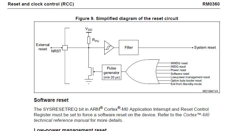

Hi
NRST pin is also an output pin. it can be driven Low from an internal reset source. So check reset flags of clock controller's CSR register just after this described reset to find the reason of unexpected reset.
2019-05-08 7:21 AM
Thanks for the suggestion. I have checked CSR register but their is no flag tick, infact MCU keeps running in debugging mode bechase NRST pin not drop below 1V. It just drop between 3.3V and 1.5V. Now my concern is Is it ok to use as it is in production?
Since its not making any reset but fluctuates some times.
