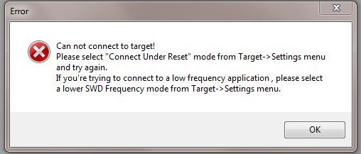

I'm using True Studio to compile a sample PWM program and using ST-LINK to program the device. It worked for the first 20 or so iterations but now it won't connect. It gives me this message:
OK I go to settings and there is no where to select "Connect Under Reset" nor is there anywhere to select a lower SWD Frequency. I had changed the ABH prescaler in clock configuration of MXCube from /1 to /16 going by the PWM example I found, but when I tried to change it to / 64 it quit working.

So perhaps your code is reconfiguring the SWD/JTAG pins, or going into a low power mode. The other alternative is to strap BOOT0 HIGH, or select "Connect Under Reset" type options, which requires you also wire up NRST
