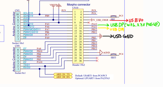

I intend to update the firmware using STM32CubeProgrammer with the following hardware configuration
Additionally, I have set the Boot0 pin to High using a jumper.

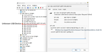

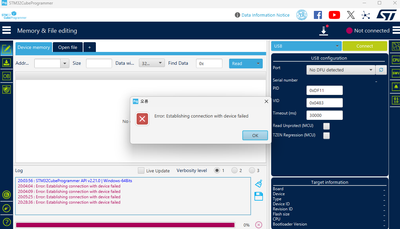

However, my PC is not detecting DFU mode.
Additionally, the programmer is not recognizing the USB connection.
Did I miss anything?
PS. The board has undergone a full chip erase.

You've missed the fact that the pullup is already present in STM32G. No need for an external one. ;)
2025-12-16 4:36 AM
The same problem occurs even in situations without pull-ups.
I am checking what I might be missing.

Just noticed that you are powering your board from USB. have you set the power jumpers correctly? What happens if you power it from ST-Link instead?
Also, if you use USB-C connector on the MCU side and C-to-C cable, make sure that 5k1 pulldowns are present on both CC lines.

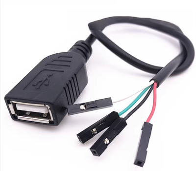

The current connection interface uses a cable similar to the one in the attached photo.
