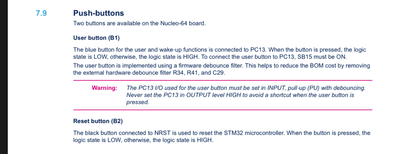

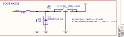

Hello ST Community team,on the MB2046 schematic, there is a button called B3 or Boot mode pin:But the UM3353 (chapter 7.9) mention only B1 and B2:Could you please correct this on the coming doc revisions.Best Regards.II

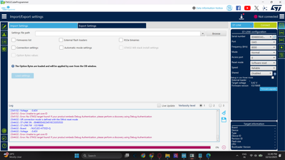

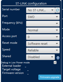

Heya!I've been borrowing an STLINKV3MINIE and today my own (legitimate) STLINK/V2 arrived today, but I haven't been able to detect it. I purchased the product from Mouser (https://au.mouser.com/ProductDetail/STMicroelectronics/ST-LINK-V2?qs=H4BOwPtf9...

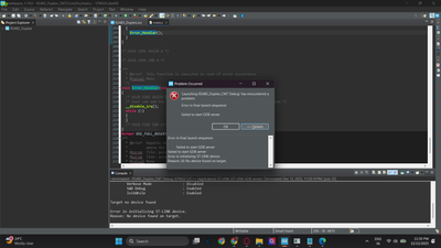

Recently brought 2 pcs STLINk V3 MODS. downloading all the documents from st site i didnot find right information(whre is SWD,SCLK, pin located in STLINK V3 MODS) so that i can connect to my target bare metal board of STM32F103 Series MCU. Very much ...
