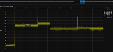

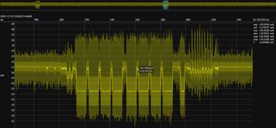

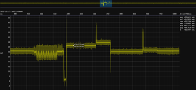

Here is the current consumption diagram without running after programming (left) and with running after programming (right). The base reset pattern for reference is the 3rd image.
The run seems to trigger the reset and put it back to idle/wait for device at the bootloader base address.

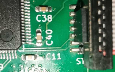

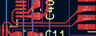

3. Please find attached the image of the connections. The quality is poor but the state is visually perfect. I'll add that no reheating was applied, nothing fell, etc. I tested the continuinty directly form the upper side of the MCU's pins to the tip of the header (STDC14). No discontinuity appears, and no "soft short circuit". The power supply comes from stable LDO 3.3V (recently re-tested).
