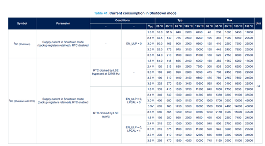

Hello, I recently got my hands on a Nucleo-U031R8 with a cortex-M0+ processor. My goal is to to reach 52 nA (using usb cable) in shutdown mode, but as of now the lowest i could go is 490 nA.

Could you please refer to STM32U031 datasheet and check the minimum current consumption can be achieve.
