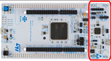

You mean the Nucleo-L4R5ZI ?
@b.a. wrote:for power consumption reasons, deactivate the ST-Link.
That board has the break-off ST-Link section (highlighted above). The surest way to deactivate the ST-Link is to break it off!

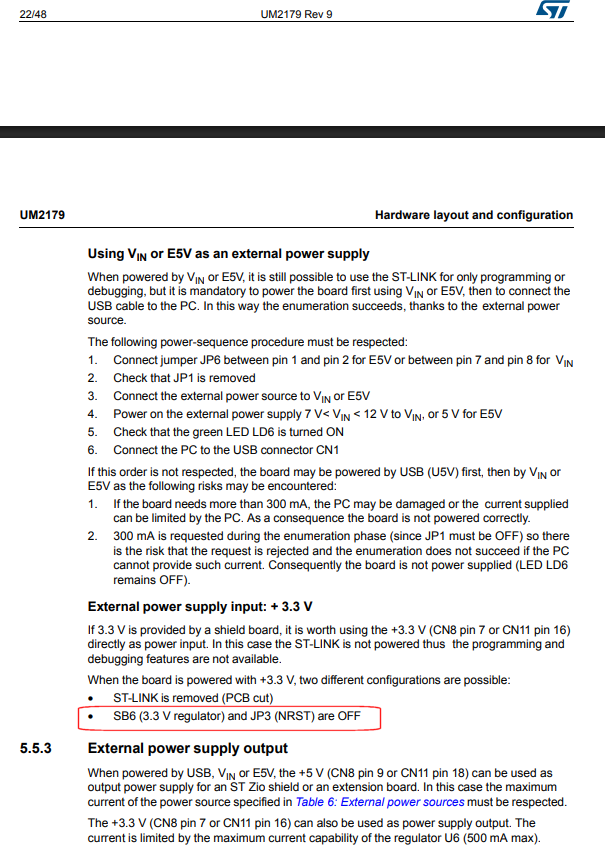

The User Manual mentions it for external 3.3V operation, but not 5V:
@STTwo-32 - is this a documentation error/omission?
