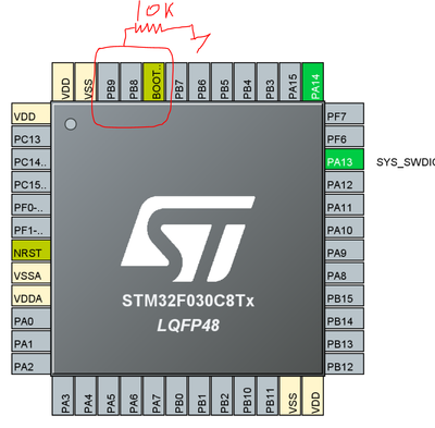

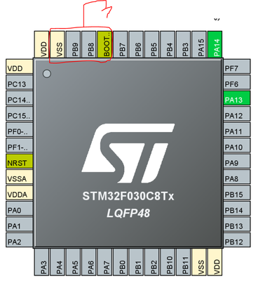

Thank you for your reply. I forgot to connect BOOT0 pin to GND. I already produced 2000 PCB on which BOOT0 is floating. I am searching a way to save my production. Is it safe/acceptable to short BOOT0, PB8, PB9 and VSS pins, thus make it GND as shown in picture? I am not using PB8 and PB9 pins in my design.

If you are not using PB8 and PB9 in the project, you can connect them together with BOOT0 to VSS i.e. GND. However, to be on the safe side, check that PB8 and PB9 are set as inputs in the program (analogue or digital) so that an output does not inadvertently try to drive VSS to VDD level.
Good luck!
/Peter

Thank you Peter for the reply. I will define PB8 and PB9 as GPIO input in software. One last question. Is it better option to short PB8, PB9 and BOOT0 pins and connecting them using single 10k ohm pull down resistor to ground or using pull down will not make any difference?
2024-01-23 7:54 AM
A pull-down is only necessary to protect the STM32 if, for whatever reason, the pin should have a high level. If you know this for your 2000 devices and can rule it out, there is no reason not to connect the pins and BOOT0 together to GND. But as @Tesla DeLorean already mentioned, low should actually be realised via a pull-down.
Good luck!
/Peter
