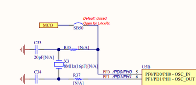

No problem - the 8MHz clk coming from the st-link onboard Nucleo-F072RB :
So it will run with HSE (8MHz) setting, set it to bypass:

I also confirmed that the HSE 8MHz clock was set to bypass and SB50 is installed.
