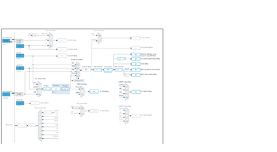

I changed from HSI48 to the PLLCLK at 48MHz without success.  Here is the clock mapping for reference.
Thanks

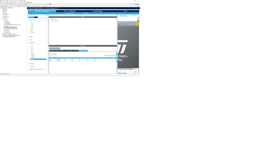

How you set the gpio pins for USB port ?
should be :  GPIO_SPEED_FREQ_HIGH;
GPIO are set to the default values, I don't see an option for GPIO_SPEED_FREQ_HIGH.GPIO.png
