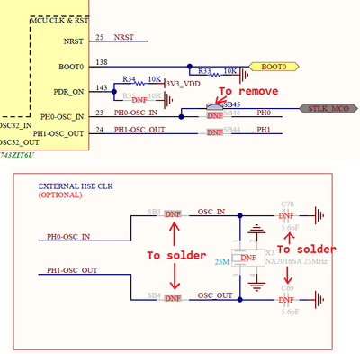

I use STM32 NUCLEO-H743ZI2 development board for my project.
I'm considering purchasing electronic components for the first time, and I would appreciate a recommendation for an X3 crystal that could be used in this situation.
Additionally,

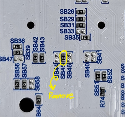

My board is currently in this state,
and I plan to solder as described in the following diagram.
Thank you very much for your guidance.

2024-04-14 9:48 PM
Thank you! However, can I just solder using the method I described? I'm a beginner and want to make sure.
2024-04-17 6:16 AM
Yes I confirm.
This is based on the schematics:
