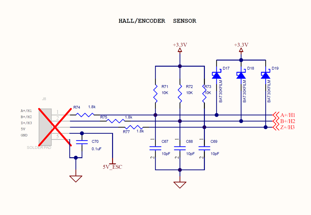

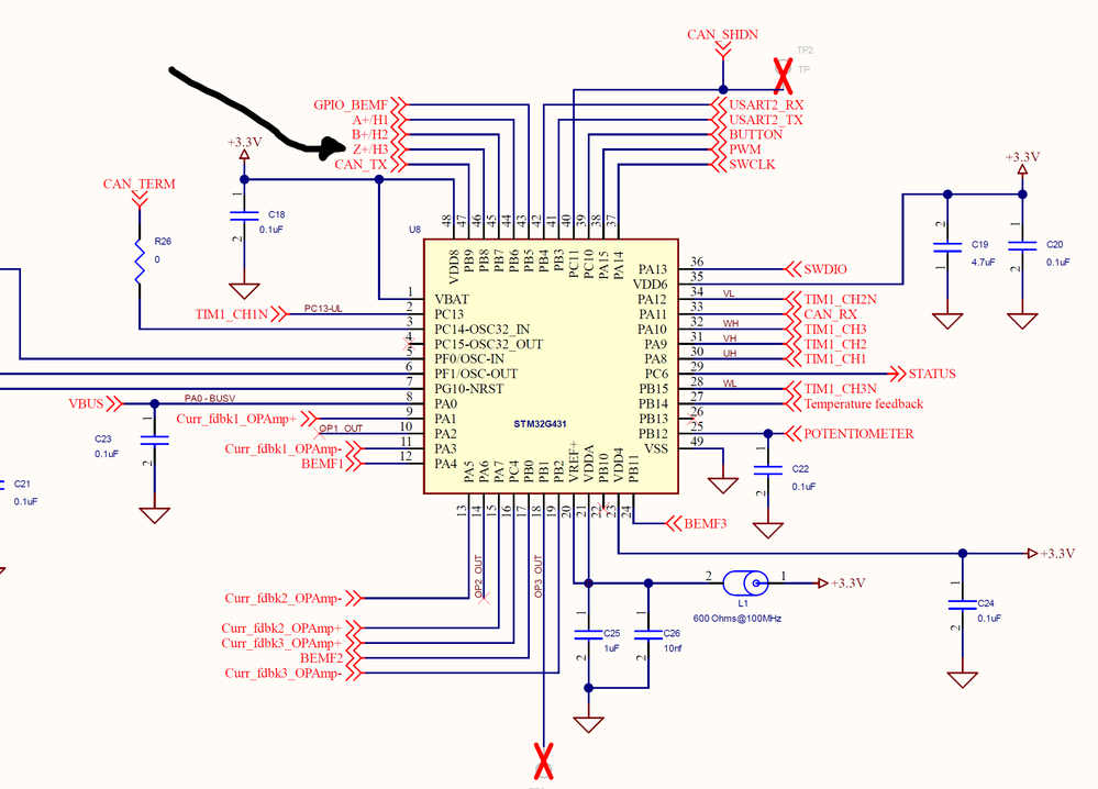

I absolutely cannot understand how the normal loading of the program on the B-G431B-ESC1 board occurs if, due to the use of timer 4 as an input for Hall sensors according to the boot0 (PB8) circuit, it is pulled up to 3.3V through a resistance of 10k. I made my board with exactly the same circuit and as expected normal boot from flash does not occur until boot0 is pulled low. Is there any trick on the B-G431B-ESC1 board?

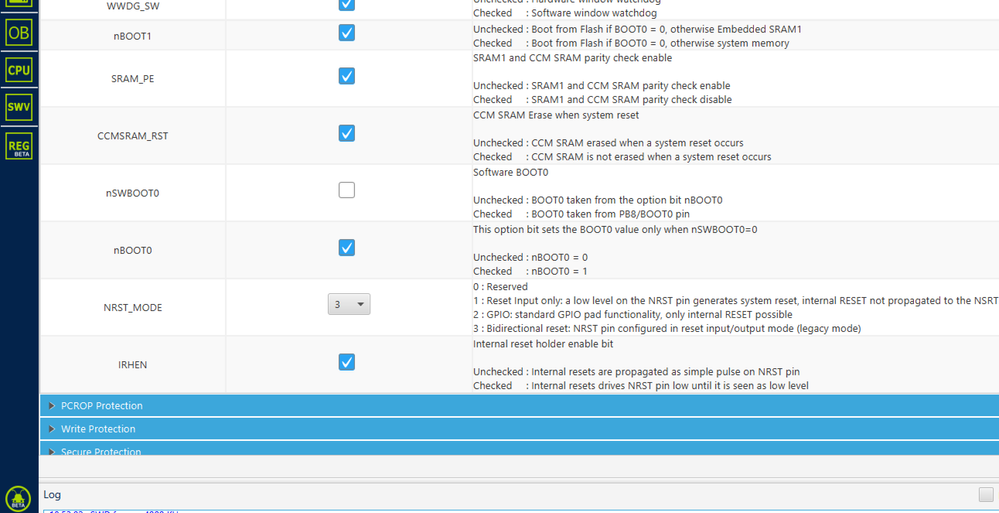

G4 familly has a software BOOT0 option, to avoid using the BOOT0 pin.
Please check SWBOOT0 / nBOOT0 / nBOOT1 option bytes with the STM32CubeProgrammer.

During production, we set the MB1419 with nSWBOOT0=0 nBOOT0=1 when programming the demo code.

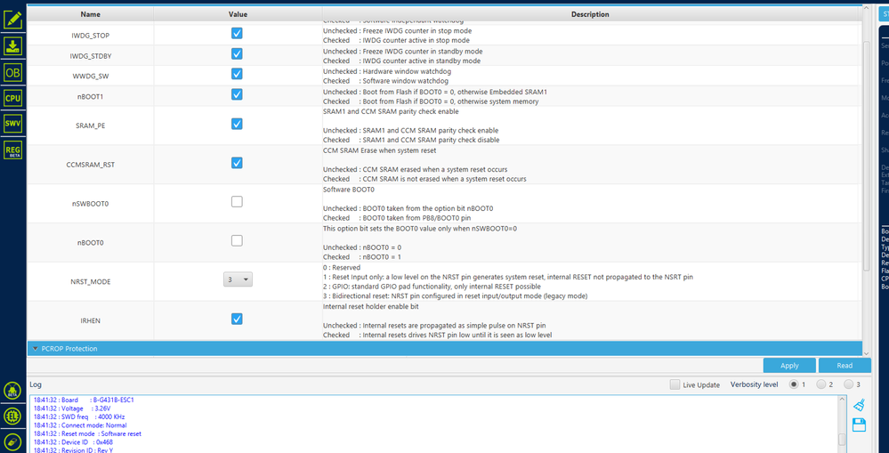

Wow, this is a real discovery :) I have already unchecked the boxes here, what else needs to be done?
2021-11-02 8:51 AM
nBOOT0 => checked
which means BOOT=0.
Your program should start after that...
