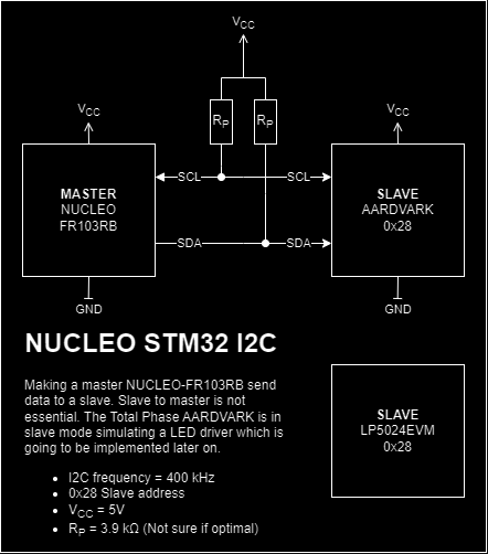

Hello, I'm trying to make a master NUCLEO-FR103RB send data to a slave device using fast mode (400 kHz). Slave to master is not essential at the moment. As slave I am using the Total Phase AARDVARK in slave mode simulating a LED driver which is going to be implemented later on.

I know there's already a lot of posts talking about the issue but I don't seem to be able to solve it. I am using a pullup resistor for each line and when "idling" both are logic level HIGH which it's correct if I'm not mistaken. When trying to send data from the MCU my oscilloscope doesn't pick up any signal. I connected the peripheriial to the morpho headers and of course in the code is I2C1.
If I put the AARDVARK in master mode and try sending data from it I can clearly see the two lines on the oscilloscope display.
Does somebody happen to know any possible solution? It's also my first time using AARDVARK, but any random peripherial will do if that's the case. The goal of this is to get me started with I2C so I can build an application for when the LP5024EVM arrives.
