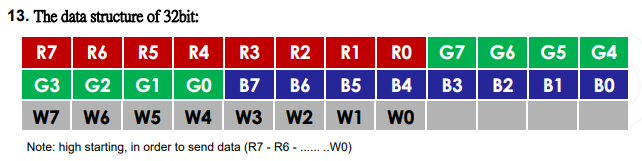

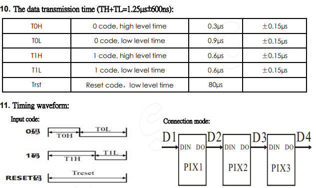

These are the timings for SK6812RBGW:

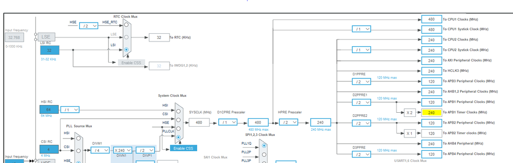

The clock is configured as so:
The APB1 Timer clock is at 240mhz

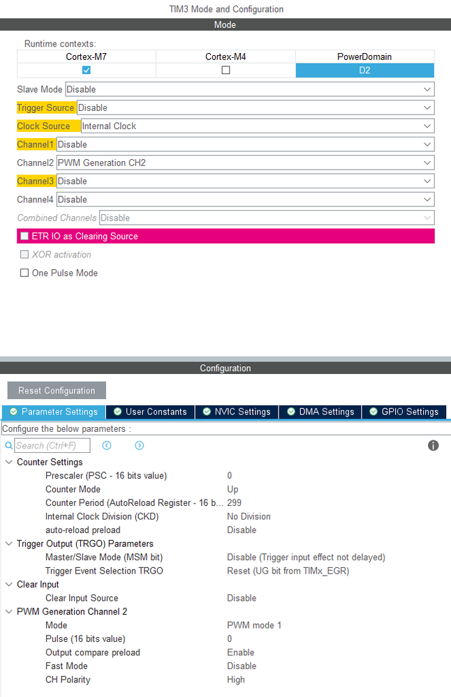

I'm using TIM3 configured as shown:

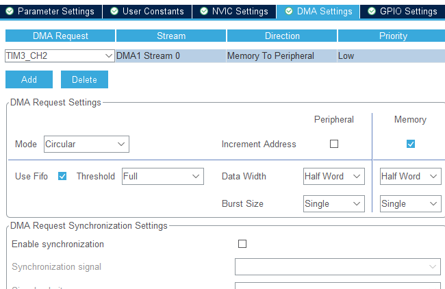

Now I've tried a few different configs of the DMA stream, currently I'm trying with half word as TIM3 is a 16 bit timer.

uint8_t w;
uint8_t b; //switch coz some reason
uint8_t g;
uint8_t r;

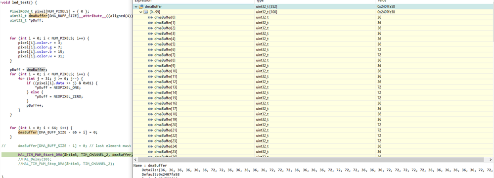

Inspecting the dmaBuffer shows the bits in the correct positions for the SK6812RGBW encoding:
I have some confusion around the ARR setting and the CCR values, as they don't seem to line up with what should and shouldn't work. With ARR set to 299, CCR for high of 144 and CCR for low of 72, my output data seems to run at 400Khz with a period of 2.5us (should be 800mhz, 1.25us). But, the bit timings are correct at around 0.6us and 0.3us respectively. When ARR set at 149, CCR high 72 and low 36, the data runs at 800Khz and 1.25 period, but the bit timings are looking like half of what they should be.
Keeping in mind I'm using a cheap handheld scope.
Either way, the LED's seem to light up randomly, which seems odd. Shouldn't they only work on one set of timings? They don't flicker or anything. They change on reset.
The other confusion is setting of of DMA, FIFO, Normal/Circular, memory length etc.

1. Why don't you use UART or SPI instead of a timer?
2. You are sending 16 bit PWM duty values (correct) but your PWM data table is 32-bit -> clearly an error.
3. Your data table occupies over 1200 bytes of stack space - not really a good idea.
4. Once you start the DMA transfer, you data table disapears/gets destroyed while the DMA continues. Declare the table as static!!!
5. Check the timer clock frequency shown by CubeMX in clock config tab; look at the for TIMER CLOCK boxes, not primary ABP clock.

I also had to increase the PWM timings a little bit, not sure if this is due to the pullup resistor or some other factor.
