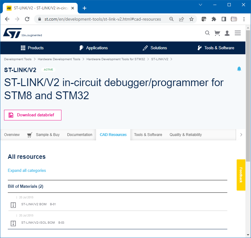

The BoM is available for download:
2022-05-23 7:01 AM
Good find! Thanks a lot!

The Product Page is always the place to start!
