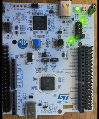

I receive the same error message while trying to use STM32CubeProgrammer. Here is a screenshot of my board plugged in.
eProgrammer.

I am able to access my NUCLEO-H503RB board on my MAC computer.
On my PC, I see the boards for my non-USBC STM dev boards in Device Manager, but I do not see them for my USBC boards.
My work computer is Windows 10. Do I need to update the Windows 10 ST-Link driver?
I am looking around for a new cable to try.
2025-03-28 1:34 PM
Trying a 3rd cable was the key. It is quite touchy on the USBC cable.
With the 3rd cable, it shows up on my Device Manager and I can connect to it via STM32cubeIDE.
I am considering this issue resolved. Thank you for your help.
