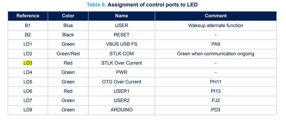

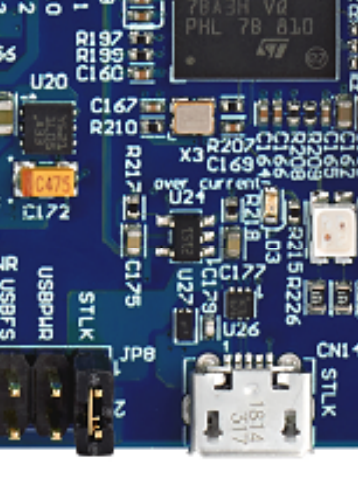

2022-12-16 9:43 AM
Hmm this board maybe isnt for you ... but check JUMPER and use only this con to PC

2022-12-16 9:53 AM
I have done all those step which you have mentioned and used the jumper at the right place but the issue not resolved yet. I am doing last three four weeks
2022-12-16 10:09 AM
Somethink is bad , you need know what ...
measure board and repair .... Discovery kits with STM32H745XI and STM32H750XB microcontrollers - User manual
